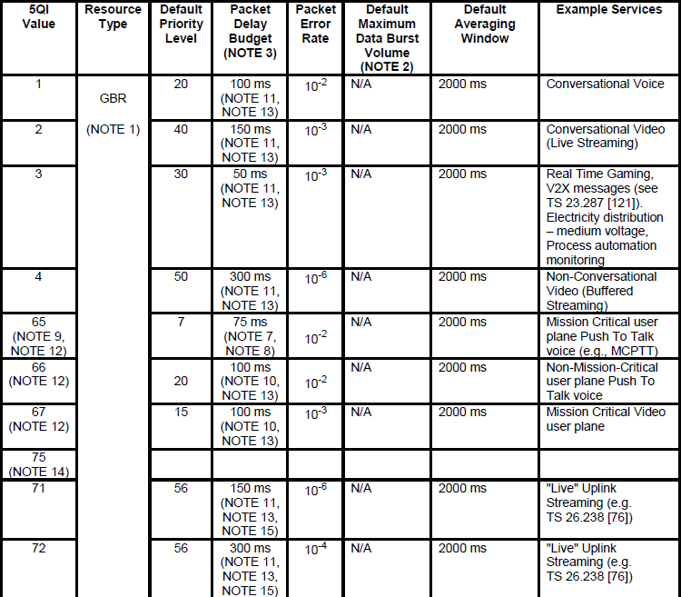

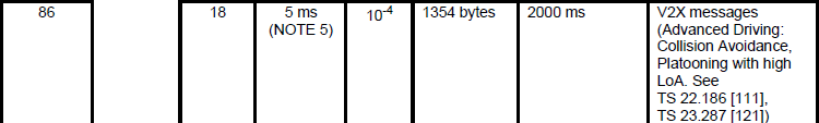

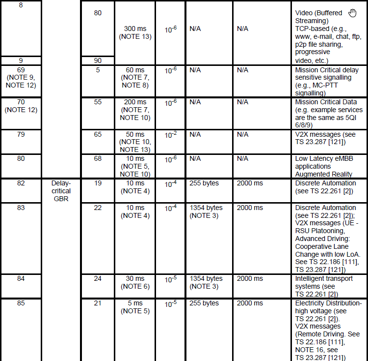

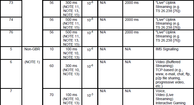

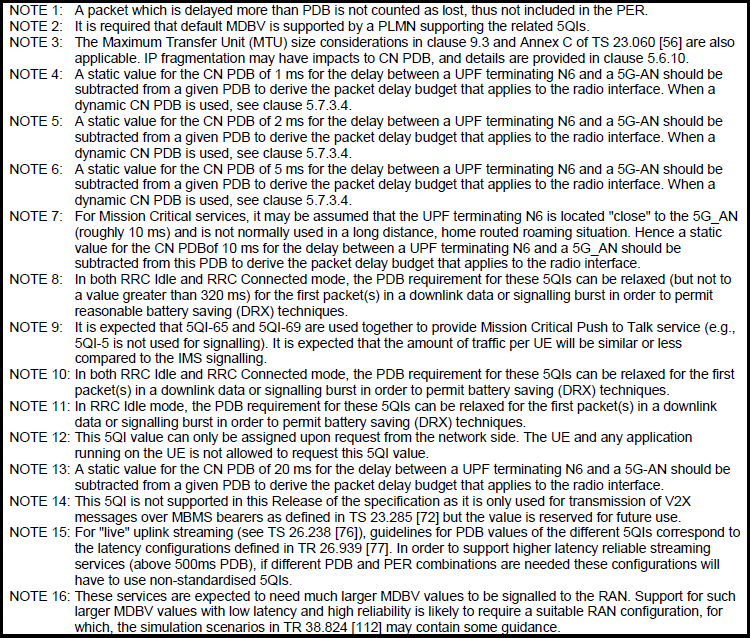

5QI
5QI is equivalent to QCI in LTE. It just has more options and granularities. It is an indicator that represents the level of Quality of Service listed as below.
< 23.501 - Table 5.7.4-1: Standardized 5QI to QoS characteristics mapping >
Reference :
