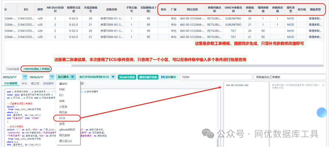

  • select *,'' as 地市,'华为' as 厂家,ECGI AS 网元名称,'RETSUBUNIT' as 参数对象名称,
  • 'SUBUNITNO' as OMC中参数名称,"天线设备编号" as 参数组ID,"子单元编号" as 现网参数值,
  • "子单元编号" as 参数修改值,'MOD' AS 操作类型,'' AS 指令组 ,'普通参数模板' AS 模板类型
  • from temp_info_700M电子倾角
  • where 1=1
  • and _查询条件_ in ({aa_str})
  • and "设备名称" like '%700%'
  • union ALL
  • 'TILT' as OMC中参数名称,"天线设备编号" as 参数组ID,"实际倾角(0.1度)" as 现网参数值,
  • '' as 参数修改值,'MOD' AS 操作类型,'' AS 指令组 ,'普通参数模板' AS 模板类型
  • where 1=1

执行结果共返回两张表,内容如下:
